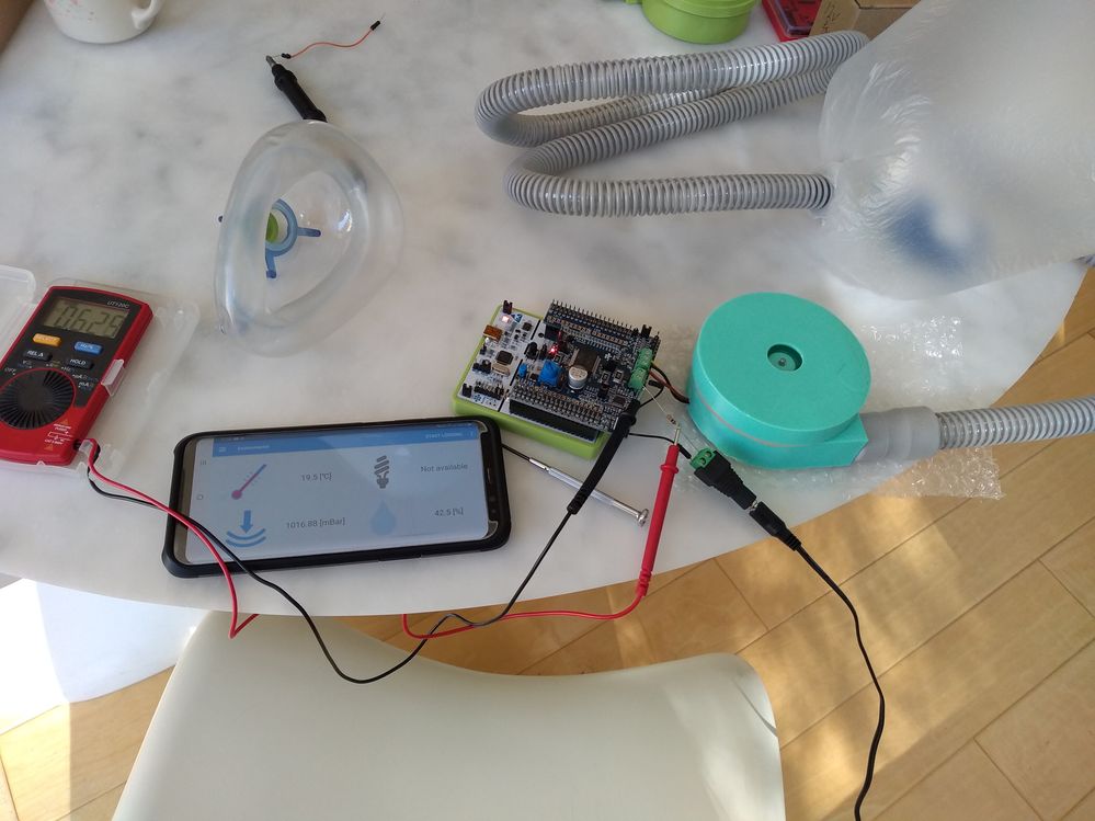

2020-05-19 9:31 AM
I am planning to use the board and the motor in a COVID response ventilator, so this is a bit urgent!
2020-05-19 9:33 AM
