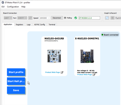

You can do HALL sensor profiling with Motor pilot profiler.
Using WB6.2.0, please generate a project with main speed sensing STO_PLL, Auxiliary sensing set to HALL (for this, go on motor box and switch on HALL sensor if not already set) and set "Motor Profiler" in Application Configuration tab.
Launching Motor profiler, once motor profiler done, you will have HALL sensor profiler:
