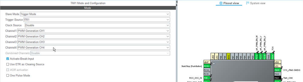

Is there a way to toggle an I/O pin when the ADC sample is actually taken? Then I could look with the scope to see when the current is actually sensed compared to the corresponding phase Vgs waveform
2022-03-03 4:51 AM
Using CubeMx, you can output the TIM1_CH4 that is linked to the sampling position:
2022-03-03 10:56 AM
Ok thanks I will check that out.
