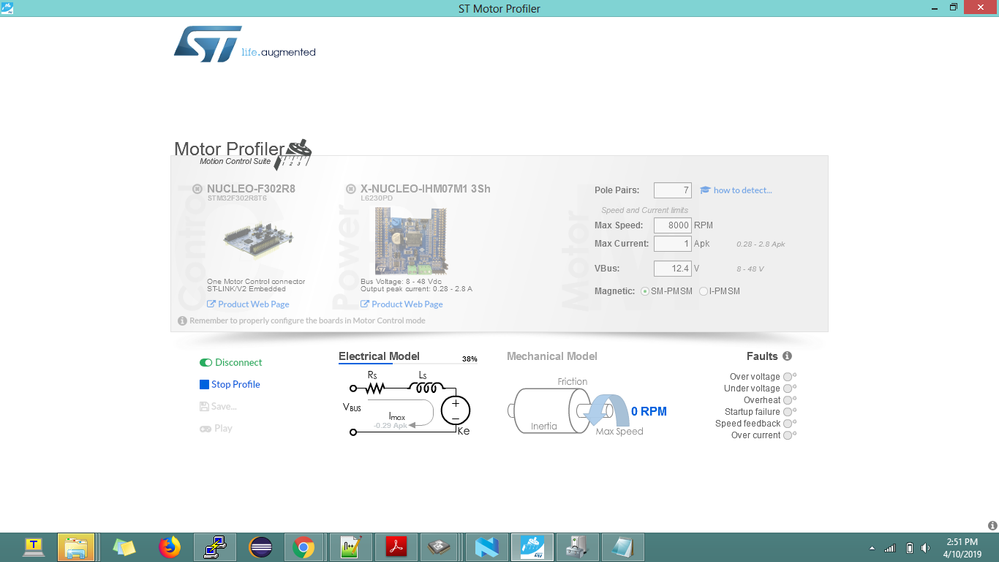

I have tried decreasing the speed to 7000rmp and current to 1A but nothing changed.
I will attach the screenshots in hope that it might help.

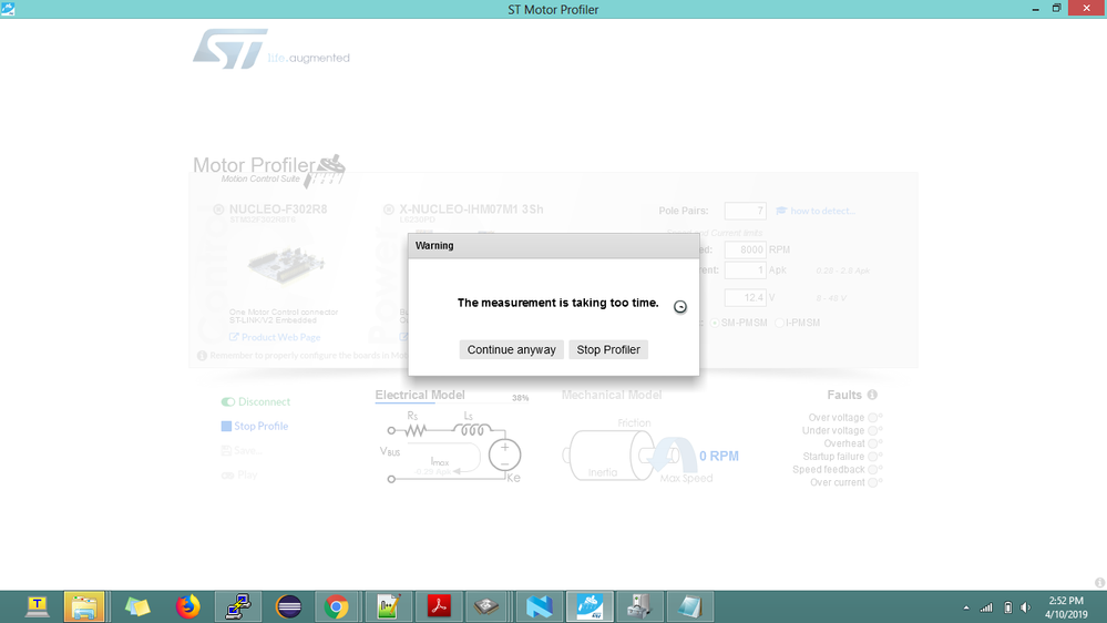

The profiling stops at around 38 % of electrical modeling status and then prompts this message below
Even after clicking "continue anyway" the motor doesn't run.
