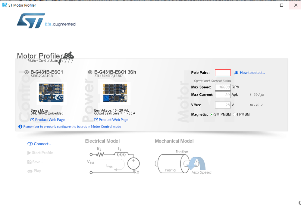

I would like to ask you, if there is possible to get the basic source code that you are uploading to the STM32G431CB ? I am using it with that basic code, with a MOTOR PROFILER GUI. I am trying to change the motor rotation periodicly (eg. after 3 period the direction of the rotation should change IMMIDIATELY) but with the help of the GUI it changes very slow... I would like to modify the code, I just do not know, which code should I download?

I am using the following GUI in this setup:
it works perfectly with it, so I am looking for that code.
