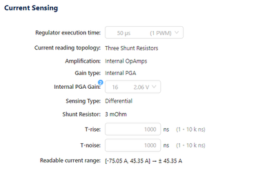

Yet, on WB view, I got these :
I'm working on a custom Inverter with a STM32G431RTBx and all the other features show up well.

2023-12-07 7:39 AM - edited 2023-12-07 7:46 AM
Hello @cedric H,
Thank you for your time and your reply.
Here's a bit more background on my use of the tool. I want to evaluate the software generated by ST Workbench on our own motor controllers and motors (which run today on our own software).
- I want to use 6-steps only. MCU used is a STM32G431RBT6 (which is compatible with FOC and 6-steps). I am not starting from a ST board but I'm using them as examples to build my controller's board description.
The driver used is DRV8350RSRGZR but we want the software to be as driver-independent as possible, as the driver may change in the near future and it already has two single-shunt (redundant) current measurements in place.
You are right ! We do not use raw current ! We have two amplified current input. I want to use one for current sensing, and the other for overcurrent potection with a internal comparator and internal generated reference (as we do in our proprietary software). The two currents inputs have the same amplification ratio. Maybe this is impossible with the workbench ?
