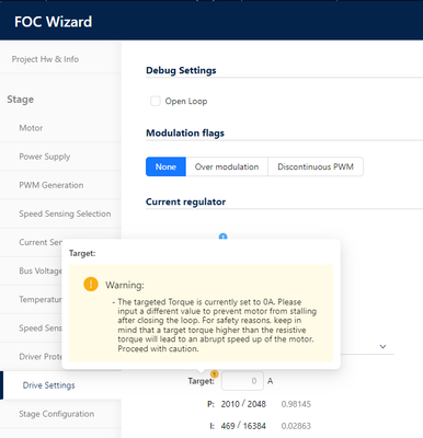

By default, the workbench tool does not set an Iq Torque target:

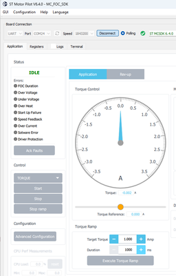

You can set a default target during the project generation step or in the MC Pilot user interface before starting the motor:
