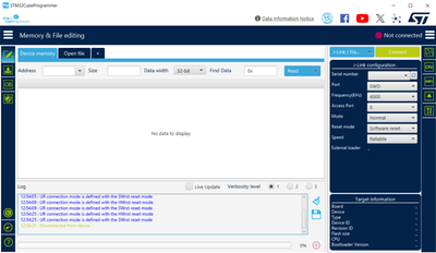

I have read all of the getting started guide, and I do not have a firmware upgrade option in STM32CubeProgrammer v2.20:
2025-08-06 12:25 AM
Hello @sargross,
Select ST-LINK instead of J-Link option.
