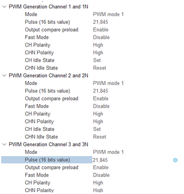

I am designing a controller that will drive a 3 phase BLDC 0.5kW motor. I choose STM32G474VET3 to generate the signaling with external gate driver and some beefy MOSFETs for that.
The MCU has advanced timer controller, and for my application i went with TIM20, ch1, ch2 and ch4. I see they can generate "PWM Generation CH CHN". How ever i dont see how to generate those with proper phase shift for a 3phase motor.
Can you please provide me some guide lines how to generate 3 phase pwm that is properly phase shifted. Which settings in the Cube i should look in to. If you have any app note i take a look it would be appreciated.

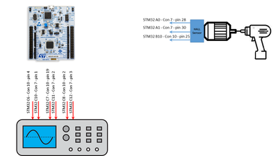

I have made a small test bench setup to test this. I have a NUCLEO-STM32G432RBT. I also have a BLDC with hall sensors attached to it. Currently BLDC is not driven by anything ... the phase connections are unconnected. I attached a drill machine to the shaft of the bldc and made it spin. On the scope i measure the 3 hall sensors and they are as they should be as the shaft is turning.

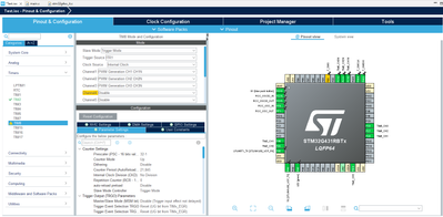

I am trying to implement what is described in RM0440, on p1159 sec 28.3.29. I have connected the 3 hall sensors to the NUCLEO on Timer2 pins (A0,A1, B10). As the drill machine is turning the hall sensors generate the pulses and drive the NUCLEO. I have configured TIMER8 to be in slave mode, with trigger ITR1 and source.
After CubeIDE generates the code i add following
// ENABLE Hall
__HAL_TIM_ENABLE_IT(&htim2,TIM_IT_TRIGGER);
__HAL_TIM_ENABLE_IT(&htim2,TIM_IT_UPDATE);
HAL_TIMEx_HallSensor_Start(&htim2);
HAL_TIM_TriggerCallback(&htim2);
// START Commutation events
HAL_TIMEx_ConfigCommutationEvent(&htim8, TIM_TS_ITR1, TIM_COMMUTATION_SOFTWARE);
HAL_TIM_PWM_Start(&htim8,TIM_CHANNEL_1);
HAL_TIM_PWM_Start(&htim8,TIM_CHANNEL_2);
HAL_TIM_PWM_Start(&htim8,TIM_CHANNEL_3);
I am then just connecting my oscilloscope to the NUCLEO to see if PWM are generated and they are NOT. I know i should also enable the Inverted pins, but for now i would be happy just with 3 pins. Any suggestions on what to do?

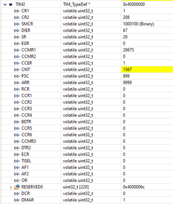

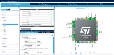

2023-11-01 9:03 PM
Hello
so i have taken your advice. But i wanted to start a bit more simple. On my P-NUCLEO-IMH03 I implemented my hall sensors on TIM2. The STM32G431 is running on 90Mhz so i first scale down with pre-scaler 900-1, then counter period 10000-1. In the main.c i add lines
HAL_TIMEx_HallSensor_Start_IT(&htim2);I also implemented Callback function to read hall sensor state
void HAL_TIM_TriggerCallback(TIM_HandleTypeDef *htim)
state = get_hall_state();
uint8_t get_hall_state(void)
uint8_t _state = 0;
if(HAL_GPIO_ReadPin(HALLA_GPIO_Port, HALLA_Pin) != GPIO_PIN_RESET)
_state |= 0x01U << 0;
if(HAL_GPIO_ReadPin(HALLB_GPIO_Port, HALLB_Pin) != GPIO_PIN_RESET)
_state |= 0x01U << 1;
if(HAL_GPIO_ReadPin(HALLC_GPIO_Port, HALLC_Pin) != GPIO_PIN_RESET)
_state |= 0x01U << 2;
return _state;
i can compile this with no problem and download to mt STM32G4. I then set a break point once get_hall_sensor is called just to see if the "HAL_TIM_TriggerCallback" is executed. It never is. Just to se my TIM2 settings i have put a brak point before while(1). These are the settings
In the ioc, i have enabeled TIM2 global interrupt (NVIC settings).
What am i doing wrong so that TriggerCallback is never called?
