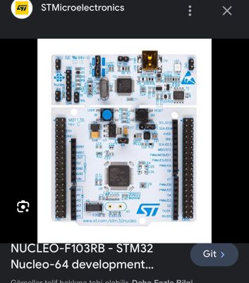

what stm32f103 card ?
2023-10-31 2:45 PM
Stm32f103rb board
2023-10-31 2:48 PM - edited 2023-10-31 2:50 PM
nucleo or what ?
show pic...name of cpu is not enough.
2023-10-31 2:53 PM
Yes nucleo.
