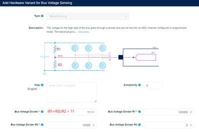

Hi there,
I generate a project using MCSDK 6.4.1 without any errors. (Find the project file in attachments)
However, when I compile my MDK project, it shows some errors as follows:
The details about the definition:

2025-11-19 12:05 AM
Thanks for your reply.
After comparing with the B-G431B-ESC1 project, I realized that the "Bus Voltage Divider" should be (R1+R2)/R2, not R2/(R1+R2).

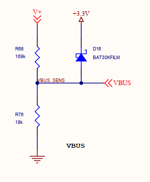

2025-11-18 11:02 PM - edited 2025-11-18 11:04 PM
The VBUS_PARTITIONING_FACTOR can never be greater than 1 it is R2/(R2 + R1)
#define UNDERVOLTAGE_THRESHOLD_d (uint16_t)((UD_VOLTAGE_THRESHOLD_V * 65535) /\
((uint16_t)(ADC_REFERENCE_VOLTAGE / VBUS_PARTITIONING_FACTOR)))
ADC_REFERENCE_VOLTAGE / VBUS_PARTITIONING_FACTOR) = 3.3 / 10.9 which will be 0
#define UNDERVOLTAGE_THRESHOLD_d (Undervoltage Value) / 0 for which it is showing error.
You have to ensure that the VBUS_PARTITIONING_FACTOR is correct.
If you verify the B-G431B-ESC1 schematic the voltage divider will be
18/(18+ 169) = 0.096
