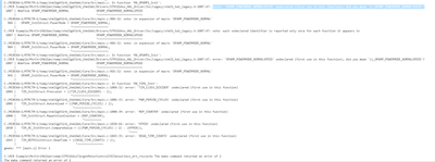

I am using the STSPIN32G4 IOC file from MC Workbench for a motor control example. However, I encounter the following errors during the build process. Since these files are auto-generated, I can't directly fix them by declaring the missing elements
Error: C:/MCB Example/MtrCtrlMdlGen/temp/stm32g431rb_ihm16m1/Drivers/STM32G4xx_HAL_Driver/Inc/Legacy/stm32_hal_legacy.h:1007:47: error: 'OPAMP_POWERMODE_NORMALSPEED' undeclared (first use in this function); did you mean 'LL_OPAMP_POWERMODE_NORMALSPEED'? 1007 | #define OPAMP_POWERMODE_NORMAL OPAMP_POWERMODE_NORMALSPEED | ^~~~~~~~~~~~~~~~~~~~~~~~~~~

Hello @AsimAsrar
Thanks for your inputs.
The issue you reported is known and already described in the release notes.
In the section known limitations you can find the following statement:
I did a quick test with STM32CubeMX 6.11 and it seems that now it is fixed.

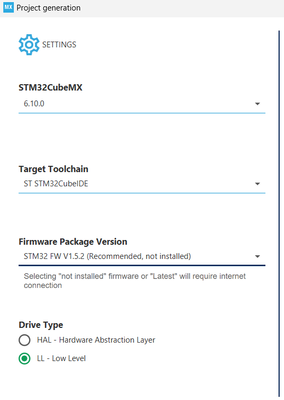

2024-07-02 8:49 AM
Hello Cedric, Below are the details.
CUBEMX Version: 6.10.0
Motor Control WorkBench: 6.3.0
While generating the IOC file I am selecting LL and not HAL.

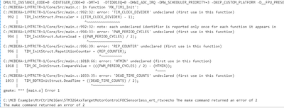

Thank you for your suggestion. Setting the OPAMP to HAL did resolve the opamp error. However, I am still encountering an error related to 'TIM'. When I configure it as HAL, I receive the following error:
Note: I had to change few peripherals to LL as I was getting the above error for them as well.
Alternatively, when I set it to LL, I get this error:
Could you please advise on how to resolve this issue?
Thank you.

2024-07-04 3:05 AM
I had to change few parameters of TIM, and it's working now. Thank You.
