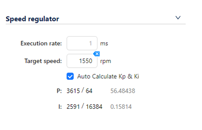

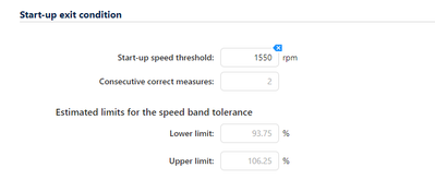

As mentioned by Gael, to have a smooth transition between open and closed loop, Target speed must be close to the switching speed threshold if you do not apply any ramp (just start motor). In the workbench it means those values:
and
The advice is to limit the open loop at the good speed to guarantee a robust startup, but once the loop is closed, the speed regulator will try by default to reach the target speed in 0 second. So if the target speed value is far from the startup speed threshold, you will observe a huge acceleration as soon as the loop is closed.
