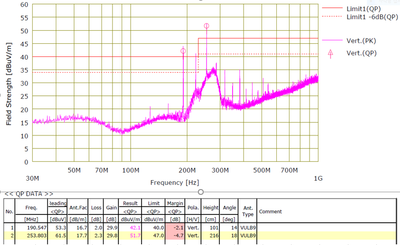

I took tests for Farfield EMI Report at STSPIN32G4 Standby condition
Report shows QP are over than Limit at 189 MHz, 252MHz. It doesnt depend on the input voltage and the signal peeks are visible also if the microcontroler is running in the loop only.
Similar problem has also another user Dkim-39 and here is his measurement. Do you have any solution for this problem?
