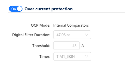

The TIMx_BRK_M1_IRQHandler is used for over current protection as you can see below in MCSDK
Also an ST document explaining it How to use PWM shutdown for motor control and digital power conversion on STM32 MCUs - Application note
So, in your when you remove 12V there is over current triggered. To avoid it you need remove the protection which is off course not recommended.
