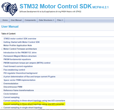

I think the answers to your questions are fully described in the User manual in the highlighted section:
