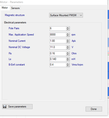

For the Motorparameters I couldnt find a datasheet so I had to determine them.
The pole pairs parameter is determined by spinning the motor with my hand. Full rotation counted (12 steps so 6 pairs).
The board is powered with 11V.
The Rs and Ls are measured with a multimeter and a LCR meter.
The BEMF constant I calculated: 930KV, 930rpm/V = 0.0011V/rpm 1.1V/krpm
1.1/(2 * squareroot(2)) = 0.38 Vrms/krpm.

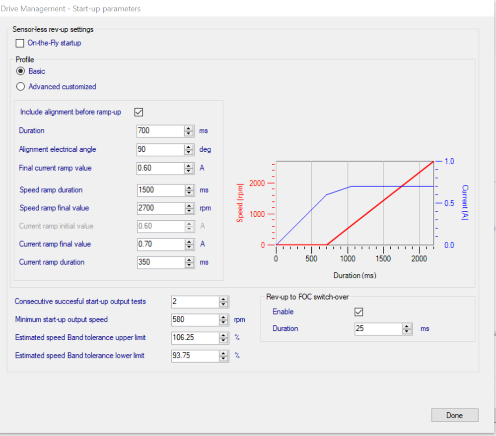

On the startup parameters I didnt change much just default from the example BullRunning Motor 1700kV.

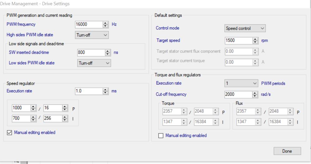

Drive settings are also all default

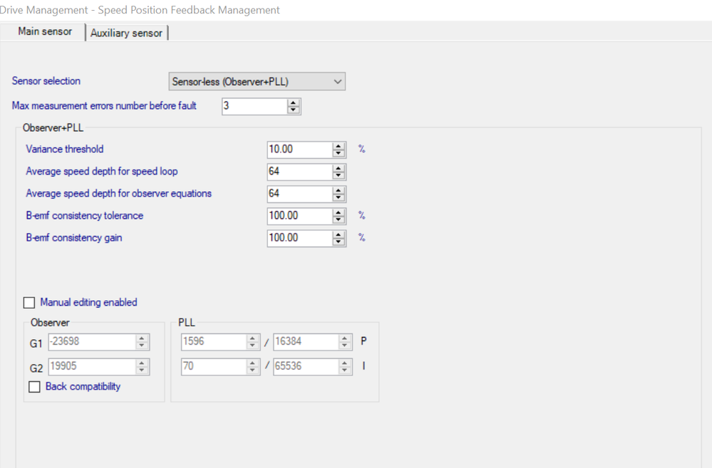

Speed sensing is also sensorless
I have tried both MC WB(5.4.8 and the 6.2.1) and what I find remarkable is that in the 5.4.8 version the speed monitor wont work it just freezes. By the way I am new to BLDC motors.

As mentioned in our MC Wiki page, the number of rotor stable positions in one mechanical turn represents the number of pole pairs.
If you are measuring Ls and Rs between two phases you have to divide these values by two. Workbench parameter is between phase and neutral.
