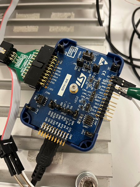

Could you describe me your ST-Link setup please? Is it a version 2 or version 3? Is it external or integrated on your board? How is it connected to the STM32 target?

Hello and thanks for you answer. The ST-link is external and is a V3, connected to the target via a ARM20-CTX 20-Pin to TC2030-IDC Adapter and a segger TC2030 cable.I already ruled out a possibly bad connection by soldering the wires directly to the target - no change.

Could you send me a picture of your setup please?

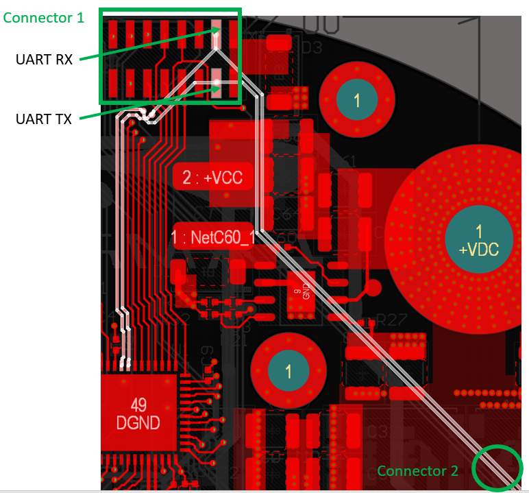

Have you route your UART signals carefully on your PCB? (Keeping them together as close as possible with some shield around and without any noisy signals close to them?

the routes for UART go from the µC to a first connector and from there to a second connector, the UART routes to the second connector are normally only used for flashing the device, while the UART connection to the first connector are used for communication with motor pilot during operation.
the the traces are routed on 2 different layers L1 & L2, L1 is the red layer shown, L2 has only signals on it, no power lines. No shielding is used. The Power MOSFETs are on layer 6, with a ground layer on layer 4.

Could you make a trial of cutting trace going to connector 2 close to connector 1 and to connect the uart on connector 1 with short wire?
