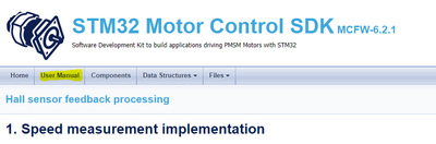

2024-01-05 1:41 PM
Hello @_Danny_ ,
The best advice I can give you is to read the User manual, section Hall sensor feedback processing.
For the implementation detail, we cannot offer more than the commented implementation sources.
So, I advise you to generate a project for a supported series with hall sensors enabled, and dive into the code!.
Now if you have specific question, do not hesitate to ask on the forum, but please in a new thread dedicated to your question, not in this one which is already answer for 1,5 years.
Best Regards
Cedric
