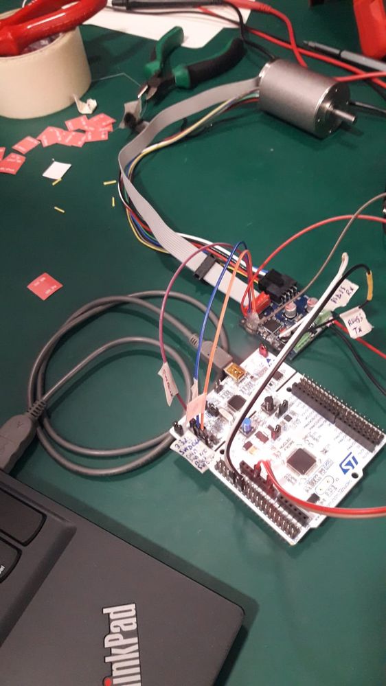

Hello everyone, I've a STM32F303RE & EVALKIT-ROBOT-1 kit. But ı dont control this system.How do ı connect this Stm32F303RE and EVALKIT using MODBUS protocole?
I tried connection using motor control software but i couldn't.
