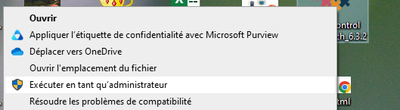

After some testing this morning, MC Workbench is able to find STM32CubeMX when it is launched in admin mode

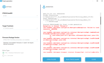

But there are lot of issues,for example Board Designer and Board Manager doesn't work and I have the following error when I generate my project :
Attached is the full log. Hope this can help.

The image you are sharing is from MC Workbench and the log inside is the one coming from CubeMX, in case of project code generation there is not interaction with Board Designer or Board Manager. You can open the relative .ioc file directly from your CubeMX application and generate the code from there.

I have been able to find a workaround to generate the code without issue.
1 - Install MC Workbench for all users
2 - Install STM32CubeMX for all users
3 - Then I have to restart the computer and log with the admin account.
Like this I am able to use MC Workbench without issue.
If I log with an user account on the computer it won't work even if I start MC Workbench as an admin.
