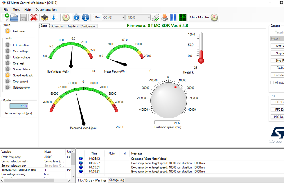

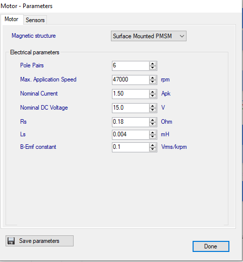

I went back and created a conservative motor profile for the EMAX 1106/6000 from values measured independently to:
Generated code. Compiled it in STM32CubeIde and uploaded it into the board.

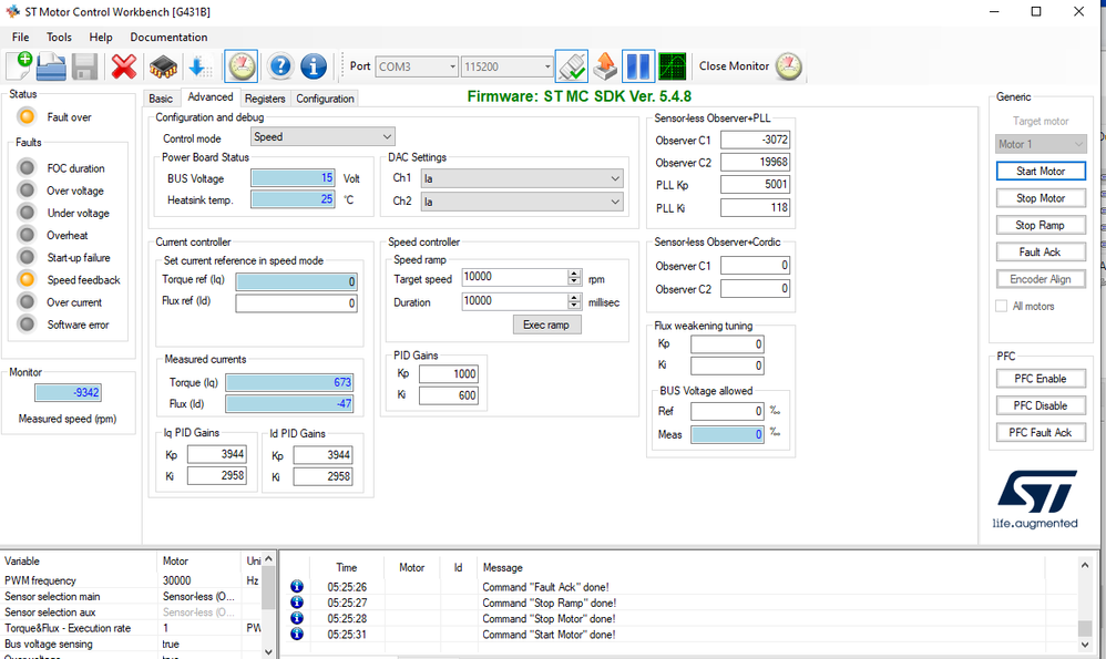

Back in the motor work bench, connect to the board and run Start Motor - the motor moves slightly and starts.
In the advanced tab - set the Speed controller to 10000rpm and 10000ms. Press Exec ramp - nothing happens - the motor does not run. Note there looks to be a speed feedback in orange warning - why?
Any ideas?
I am running my power supply at its maximum 15v - do I need "3s" (21v~)? The motor is a 2s/3s motor, does the board needs this level of voltage?
Please please improve your documentation. Start with a simple diagram that describes the workflow. Provide more info about errors. Fix the UI. It took me a while to even find the Exec ramp.
What would you do if you were me to get this to work?
2022-12-13 9:29 AM
I set the "Nominal dc voltage" to 8v. and reran. The motor tries very hard to run after start motor. After a couple of secs this appears - Speed feedback
What does this mean?

I seem to be talking to myself. Is there a better way for some of these questions to be answered?
Is there a reason the speed dial is negative? I'll try swapping a couple of motor leads, but can this cause an issue?
The measured currents are quite high, and there are lots of things to tweak. Do the gains for the current control need to be altered, e.g. Iq/Id Kp & Ki.
There are gains (Kp & Ki) for a number of other features. If this motor is considerably different from ST expectations do all these values need to be set for this EMAX motor - and if so what values? Any guidance?
Am I wasting my time trying to use the significantly more complex field oriented control (FOC) and would 6Step be simpler and easier? If so how do I use the tooling to do this?

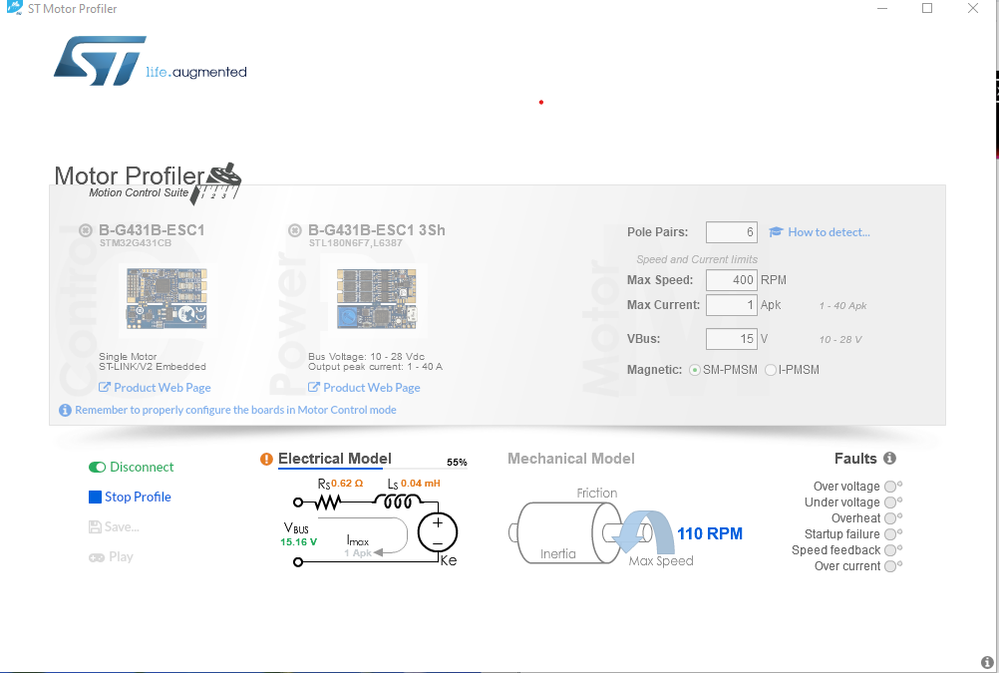

More to report - first motor profiling.
I grabbed another 1106 emax drone motor (4800 kva) that has a slightly higher impedance than the other one and grabbed a 5amp psu. I made sure I updated to the 5.4.8 and 6.1.0 mcwb.

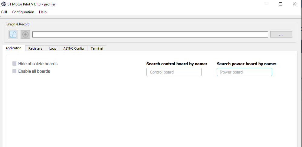

The 6.1.0 wb's profiler (ST Motor Pilot V1.1.3) is a step backwards - there seems to be no way to find the board and it's unclear what needs to be typed into the search fields to find something - more about the 6.1 wb in min ...
The 5.4.8 wb profiler mostly works. Setting as follows:
pp: 6
rpm: 1000000 (yes that high)
Apk: 2.7
VBus: 12
It seems to hit the motor with the full amount of current (and makes it very warm) and reports .8 ohms and .03 mH, and then runs it up. It reaches about 33,000 rpm consuming about 1.3 amps, at some high percentage complete and then seems to reverse the motor and do it all again before stopping at 96%-ish complete and complains about taking too long. Answering the prompt to continue restarts the cycle running the motor at 40% - it never completes whatever changes are made. ARGH
Is this a bug? Can the timeout a set bit higher? Is the rpm max value being scaled by 100? (The only way to get to 30000 is by making this value enormous)
