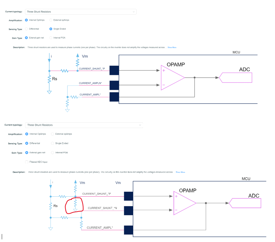

Hi Cedric
Two questions regarding this topic.
1) "Nothing needs to be changed." But the schematic of EVSPIN32G4 doesn't match what is shown as an example schematic when switching from differential to single-ended. Is this ok?
2) "Our current sensing implementation with 2 ADCs for the STO-PLL or STO-CORDIC requires that at least one phase is connected simultaneously to 2 ADCs."
I am not planning to use neither STO-PLL or STO-CORDIC for speed feedback but an encoder. Is it then somehow possible to select differential mode and use 3 OPAMPs?
