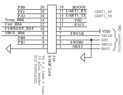

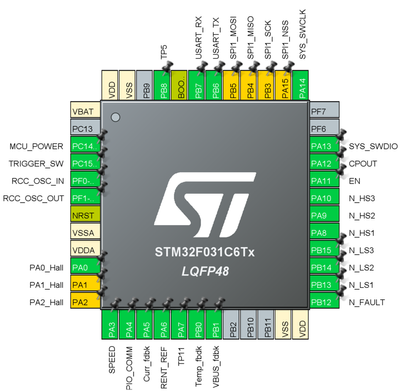

-> IOC Configuration File: In the sample project, there is an IOC configuration file. However, it seems not to correspond to the hardware configuration outlined in the STEVAL-PTOOL2V1 Data Brief documentation for the PTOOL2V1 board. Could you confirm this? If it doesn't correspond, do you have an IOC file that matches the correct configuration?

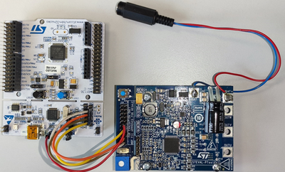

Here is the configuration I used:

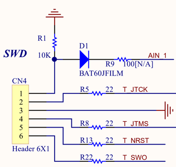

Hardware: F411 Nucleo board with disabled STlink and U5V power jumpers, wired as follows:
T_NRST STLink to NRST PTOOL
T_TMS STLink to SWDIO PTOOL
GND STLink to GND PTOOL
T_JTCK STLink to SWCLK PTOOL
+3V3 STLink JP1 to VDD PTOOL
PTOOL2V1:
ST-LINK Nucleo board :
PTOOL2V1 Configuration:

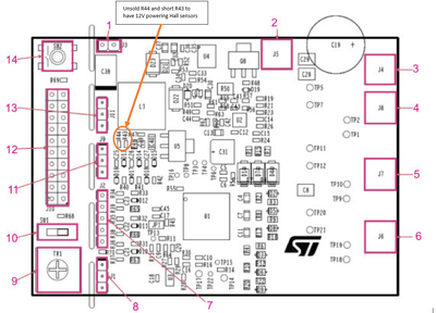

I unsoldered R44 and shorted R43 to have 12V powering the Hall sensors of my motor.

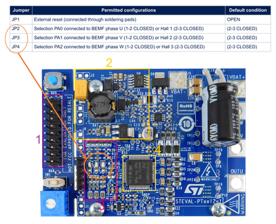

Configured JP2, JP3, and JP4 to use the Hall sensors.
The motor used for testing is a 5 pole pairs Hurst DMB0224C10002.
