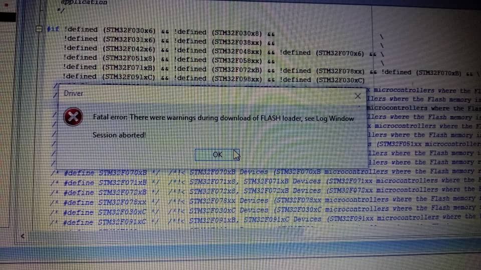

2021-07-01 5:43 AM
thanks to ur guidance cristina.
i downloaded the firmware package that u sent. issues were fixed and .hex file was made.i have new issue and can not resolve that.
IAR IDE generates a message error during download and debug progress."fatal error:there were warnings during download of flash loader,see log window session aborted:"
it would be appreciated if guide me more!

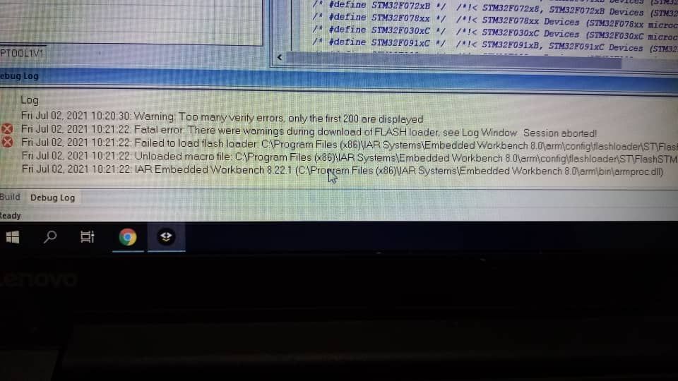

2021-07-02 10:28 AM
i have been tested "connect during reset" mode in IAR IDE and ST-LINK Utility software but my problem was not resolved.my debug log pictures is following: thanks and best regards cristina

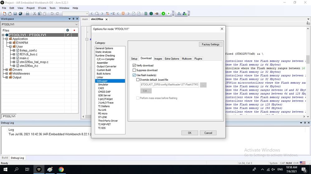

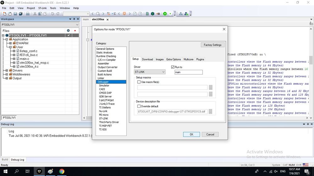

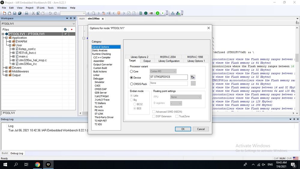

2021-07-06 11:01 AM
hello cristina
screenshots are following:
2021-07-07 1:59 AM
Hi @amoos.1,
it seems an issue related to firmware-software coupling.
I add the STM32 Motor Control tag, @Laurent Ca... could you help on this topic?
