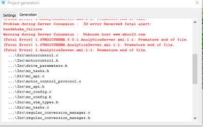

After setting all the motor parameters, the shunt resistor values and all the conditions and startup ramps and so on, I want to generate code to see what I am going to upload on the microcontroller, and here I have my first problem. When I click on generate, as you see below, I can choose as firmware package version the reccomended one(1.22.0), the one that I have installed (1.28.0) or the latest one
Whichever version I choose, there is the reqest to setup an internet connection, even for the one on my PC
If I click on yes, then I'm stuck on this other window, with this error if I click on check connection
If I decide for a NO, then this window appears, asking me for another FW version with respect to the one I select. If I click on continue, ignoring the warning , I have several fatal errors higlighted, then the compiling phase starts, and ends with the yellow text compiled with errors
And after closing the tab of generation code, onto STM32 motor control WB it appears the red writing, saying
Generation Failed
Now, if I go looking inside the folder in which I save the project I see that in fact the generation has produced some files .c and .h, but I don't know if they are correct. The same for the .ioc, that I can open on CUbeMX.
However, due to those errors, I am not sure that what I open is correct.
