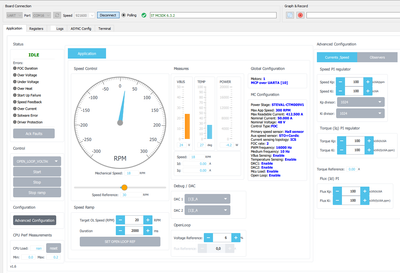

First:
There is a bug in RevUp—see the picture below. When changing the torque current values, the input value is automatically reset to 0.

The first point you mentioned is a known issue and we are working on a fix. We currently have no workarounds, sadly.

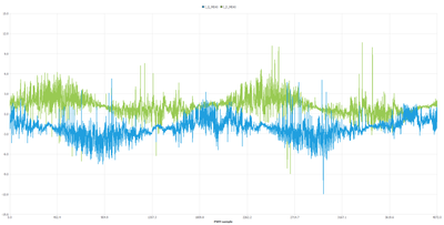

2025-04-05 2:53 AM - edited 2025-04-05 11:32 PM
the machine was operated in open-loop duty cycle mode using the specified parameters.
However, a loud rattling noise was observed, and the current measurement showed a very noisy signal.
What steps can be taken next to achieve acceptable and quiet operation of the machine?
