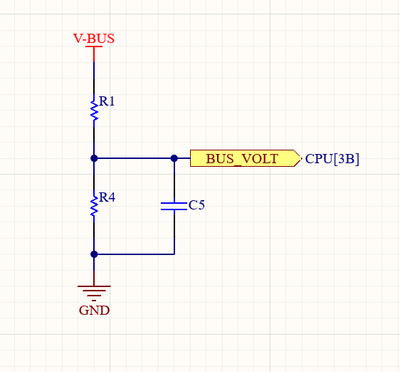

Here is my VBUS feature schematic.
I’m using a Li-ion battery pack (20S10P configuration).
I’m struggling to understand why the output power (W) does not increase under load. This issue occurs in both speed mode and torque mode. When the motor is not under load, I can provide a 50A reference in torque mode and get a corresponding power (W) output. However, under load, it seems like the battery or the software cannot provide the required power (W) momentarily.
When the motor is under load, I expect the inertia and friction forces to increase. Therefore, shouldn’t I adjust the gain? Would PID tuning help resolve this issue?

First, the voltage dropping is unlikely. Your current is stabilising at 50A, a severe voltage drop (to 0V) would also completely put your current to 0A, which is not the case. In your case, current is maxed but no torque is developed.
So we're back to the first statement : is your current measured correctly ? Do you have current probes to measure externally your current values on the three phases and compare them to what the MotorPilot is giving you ?
