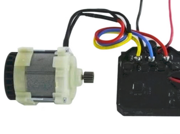

Motors:
1) BLDC A2212
Profile Settings tried so far:
No. Poles 14 (Pairs: 7)
2) BLDC
there are total of 6 windings. So this makes 3 Pole Pairs?
Results:
I tried using different max current, poles etc. But, the motor clicks and sometime runs momentarily but profiling always fails. Is there any specific sequence of phases to be used?
