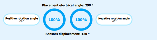

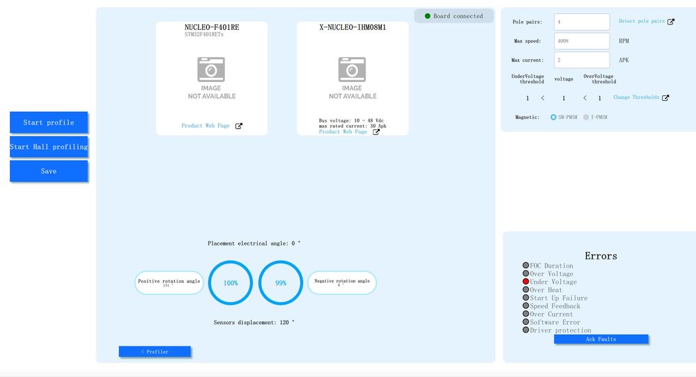

I try to use the boards to obtain motor parameters. Now I got the result as illustrated in the picture? Should I set the parameter "placement electrical angle" to 131? Thank you!

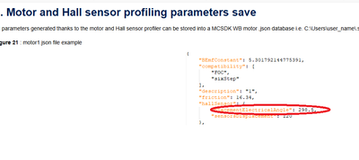

If you check the MCSDK documentation of the hall sensor profiling example
you will get the placement angle on the top they are calculating as 360 + (-56-67/2).
In your case the profiling is not complete i think it is not 100% and you did not get the value.
2025-08-26 3:16 AM

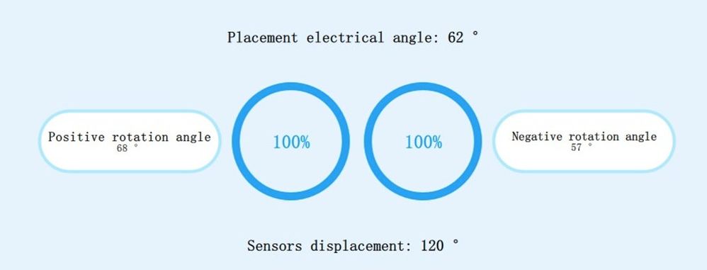

2025-08-29 7:08 AM
Hello, thanks for your reply. So in my case, I should calculate the placement angle with (68+57)/2=62, right? Thanks a lot.
