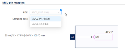

If your point is still pertinent, please consider using MCSDK6.2 WorkBench, you will be able to directly edit a board description .json file (starting from an existing one using STMC Board Manager) in order to add your new temperature measurement input as below:
"TEMPERATURE_NTC": [
"name": "PC4",
"help": "",
"cost": 0
"name": "PA4",
"help": "",
"cost": 0
Starting a new project with this modified board description, motor control workbench will give you the input choice and will generate the project accordingly.
