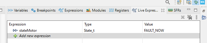

At the same time, I used "MC_GetSTMStateMotor1();" which showed me that I have 2 faults.

Currocan see the state motor here:

If your point is still pertinent, if motor state reports FAULT state, you can use MC_GetOccurredFaultsMotor1() api to get the error ID (definitions are in mc_type.h file). According to this error ID, please have a look to our FAQ page in order to handle it.
