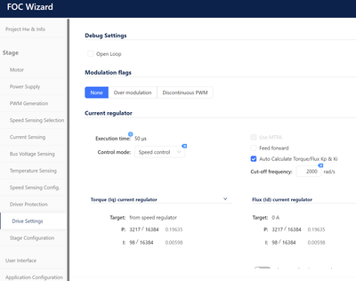

I've read that the speed feedback fault might be due to needing to lower the cutoff frequency, so I lowered it from 6000 to 2000 rad/s. But I still get the speed feedback fault.

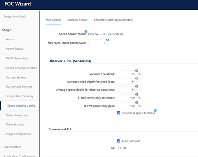

I'm not sure if there's something wrong with my current feedback config or speed feedback config? This dev kit should be running in sensorless mode (no hall sensors for speed feedback), with FOC.

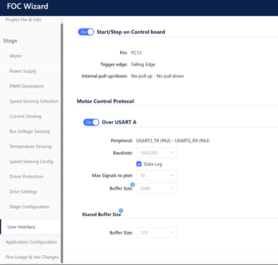

Here's some of my settings. I'm still new to this, so I don't have a good hunch on what I should be showing. I'm guessing something is the issue with my speed feedback or current feedback config?
