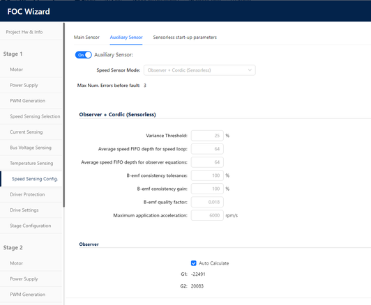

I am currently testing motor operation using the EVSPIN32G4-DUAL board.
I am using the motor’s Hall sensors for speed feedback.
In the Speed Sensing Configuration, under Auxiliary Sensor,
should the Speed Sensor Mode be set to Hall Sensor in this case?
Could you please confirm whether this setting is required for proper speed sensing when using Hall sensors?
Thank you in advance for your support.
2026-02-09 11:59 PM
Hello @pelino,
Auxiliary Sensor is not required.
