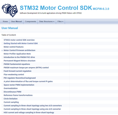

Hello @reading
All our documentation is available from the About menu of the MC Workbench. It will open a new tab in your default browser. The user manual contains all the theory and the related mathematical equations.
Regards
