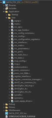

There seems to be no "esc.c" file for me in the project.
I have seen you reference that file before in other posts.
My project looks like this:

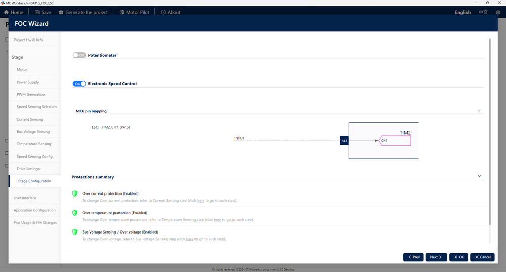

However I ticked the box for ESC in the MC Workbench:
Am I missing something?

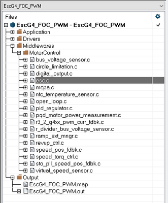

Hello @STMBatu,
esc.c file should be located inside Middlewares/MotorControl
Cedric
