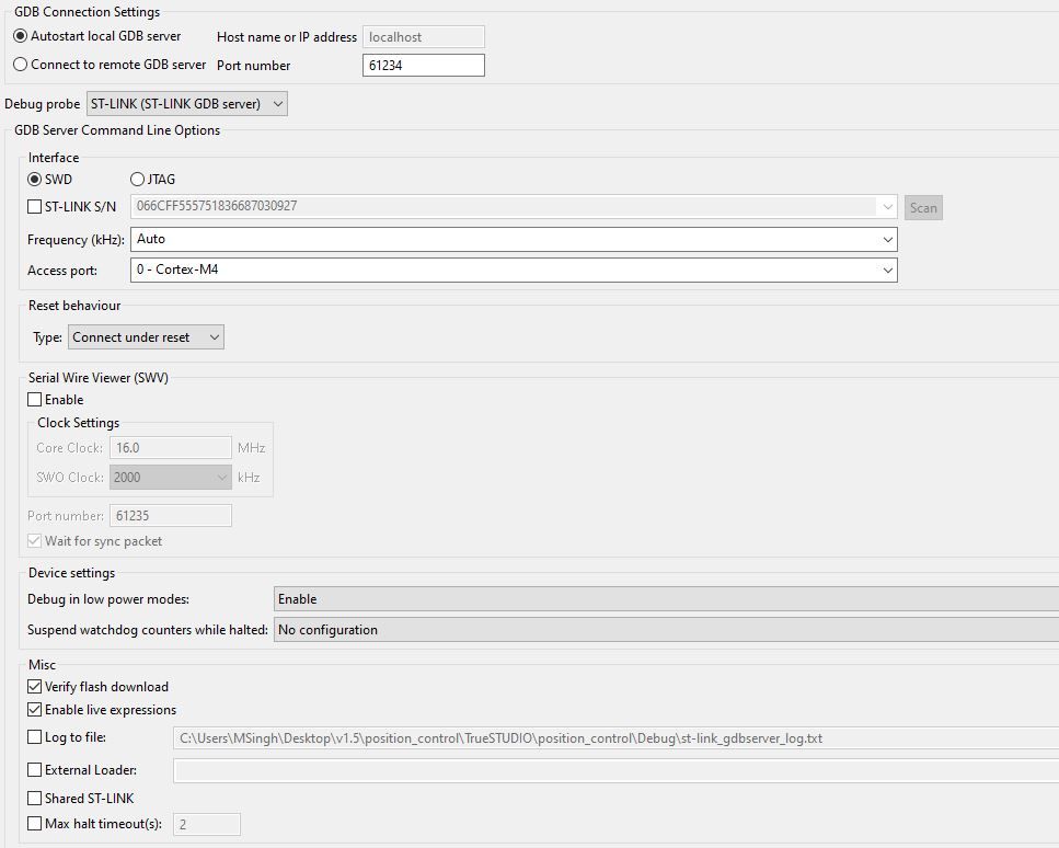

I do not see any PWM signals being generated I'm guessing that's the reason for it not to move? can the debugger configurations affect this? I had changed them to try implement printf. Here's what they look like now.
