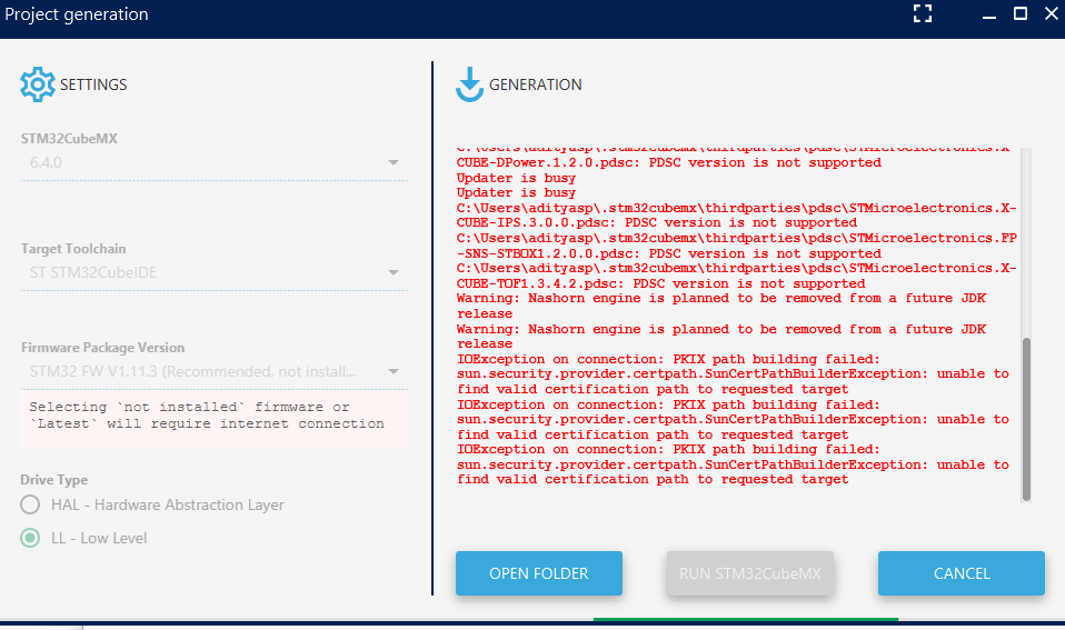

Can any one help me with this. I am facing the below error.

Hello @Aditya_sp,
Could you please try by using a "Firmware Package Version" already installed or installing the "STM32 FW V1.11.3" as required by the tool (Open STM32CubeMX, "Help">"Check for updates").

delete mentioned psdc files
