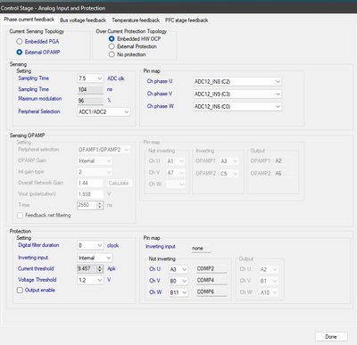

I have over current protection like this in my custom board how can i implement this on motor control workbench here is my file and i'm getting eror when i try create with six step

Could you please confirm whether you are targeting 6-steps or FOC algorithm ?
Could you provide a better resolution of your schematic, and show the current sensing part.
In the WB 5, 6-step was proposed in exemple only and was not configurable through the UI.
From all ST Boards we provide, did you take one as a reference ? It is really the recommended way to be sure that we will be able to generate your own config successfully.

needs to be internal comparators with 3 different input

Hello @TKara.2,
The 6steps algo will be supported for the STM32F3 series in the next release MCSDK 6.3.0
Regards

Hi cedric can u help me about configure the custom board i need the internal opamp type for ocp like mcsdk-5
2024-04-08 10:21 AM
like this
