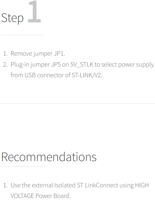

I am using an X-NUCLEO-IHM08M1 board plugged on a G431 Nucleo board and I have a question regarding the Nucleo power supply.

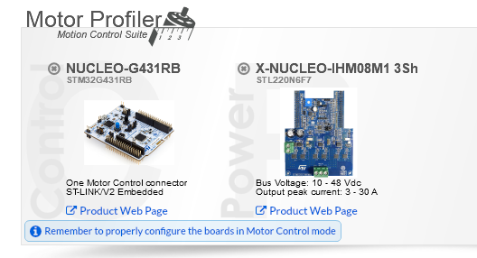

In the IHM08 Quick Start Guide it is noted that the JP5 PWR jumper must be set to E5V (powered from morpho connector), however in the Motor Profiler information page (when you click on "Remember to properly configure the boards in Motor Control Mode" - Step 1) it is 5V_STLK that is mentioned (powered from USB).
Which one should be used?
Also, is is recommended to use an "external Isolated ST LinkConnect", highlighting the Nucleo STLINK USB connector. What is this device? (the new B-STLINK-ISOL?)
Thank you.

You are right, IHM08 can not provide power to nucleo board through VIN, it only can provide 5V through E5V on morpho connector.
For nucleo, if you set JP5 to E5V, the nucleo's power is from IHM08 through E5V on morpho connector. if you set JP5 to 5V_STLK, the nucleo's power is from CN1 of nucleo-G431.
I checked motor profiler, it seems configurations for different board groups are all set to STLINK power. So you may follow this configuration.
The recommendation is if you use high voltage power board, the high voltage would be damage your PC through USB cable, so an isolation is suggested. You may look for an isolation device which is on the USB connection between PC and nucleo CN1 .

In Motor Profiler, select Nucleo-G431RB and X-NUCLEO-IHM08M and click on "Remember to properly configure the boards in Motor Control Mode"
2021-10-26 7:47 PM
Hi Grann,
B.R.
