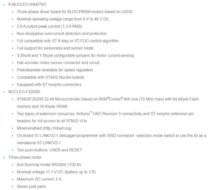

2020-10-22 10:47 AM
Thanks for your reply. I have the same config of the picture below, it's the P-NUCLEO-IHM001 kit. I'm using "Motor Profiler 5.4.4", "MotorControl Workbench 5.4.4", "STM32CubeMX", "STM32CubeIde 1.4.0".

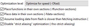

Than I set the compiler optimisation to "Optimize for speed".

2020-11-05 5:33 AM
Hello again,
now I have solve this problem bei use compiler optimation in STM32CubeIDE:
Now everithing works fine

>> In Motor control workbench "FOC duration" and "Software error" was shown after "Start Motor"
If yes, try to solve the issue using the above-mentioned compiler optimization.
