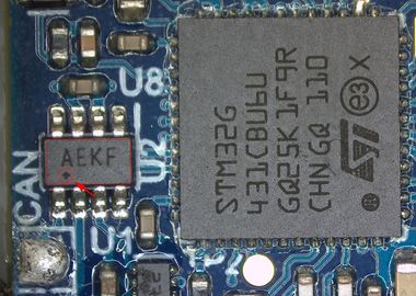

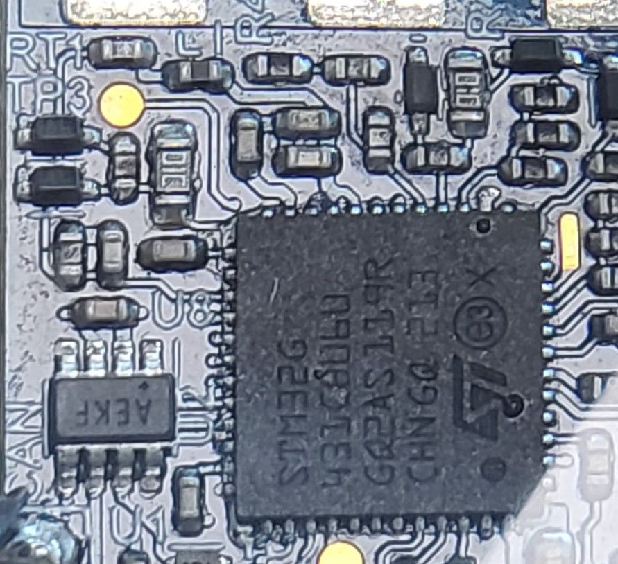

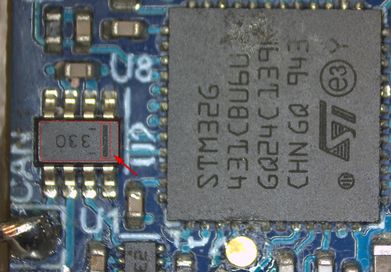

To confirm this I've checked that the CAN driver IC itself is different on new boards - the old one was marked "330" and the new one is marked "AEKF" the other odd thing I've noticed is that the new IC is oriented probably the wrong way - the pin nr1 mark is in the opposite way from the previous generation ICs, but the PCB paths vaven't changed Is this possible that there's an assembly error? To verify I need specifications for both chips - the one marked "330" and the one marked "AEKF" - I can't find them.
2023-07-13 12:11 AM
Here you have the pictures under the microscope to illustrate the issue.
Pic1: The old version - working Pic2: The new version - not working
Please give me the specs for both ICs and verify this issue also on your side.

google:
can transceiver ic marking "aekf"
=> https://www.analog.com/media/en/technical-documentation/data-sheets/max3051.pdf
same with "330":
same pinout, so yes, the assembly is screwed up...

So, I've checked in the production files of all board variants (in BOM files) that there should be the U2 => TCAN330DCNT (hence "330" marking on the IC), therefor since there's a different IC in the newest generation of the board, it is a mistake of some kind in the assembly process - a different IC (out of the specification) and/or a wrong orientation of the IC (pin 1 on the opposite side).
2023-07-13 7:55 AM
The Maxim and the TI transceivers are pin compatible, but the assembler rotated the new on by 180°. Or someone gave them the wrong assembly files, or whatever...
You could simply unsolder the IC, turn and resolder it.
Or better, give that PCB back and ask for a replacement.
