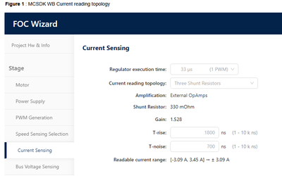

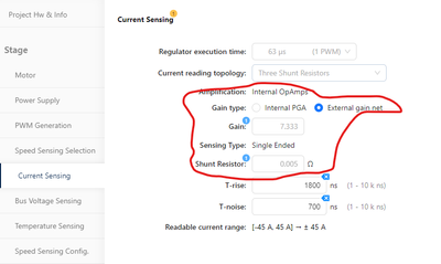

I have gone through "Motor Profiler" note. But I see some differences with MC workbench SW .
Attaching the screenshot of MC workbench and Application note description.
Application note details
The marking part of workbench SW is not matching with the documentation.
Can you please suggest what do i need to do here?
2025-11-03 2:49 AM
Hello @Sanchari,
Current sensing topologies depend on the board hardware configuration. Refer to the Board description - current sensing page for more details.
