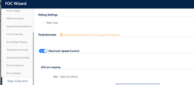

Where in the MCW config do I configure the PWM input control?
It is available in the Stage Configuration.
Is there an example of controlling the speed with the Potentiometer on the B-G431B-ESC1
The source code is available in
\CLN_MCLib\MotorControl\Any\Src
potentiometer.c
speed_potentiometer.c
You have to add to your project and map to one of the ADC's.
