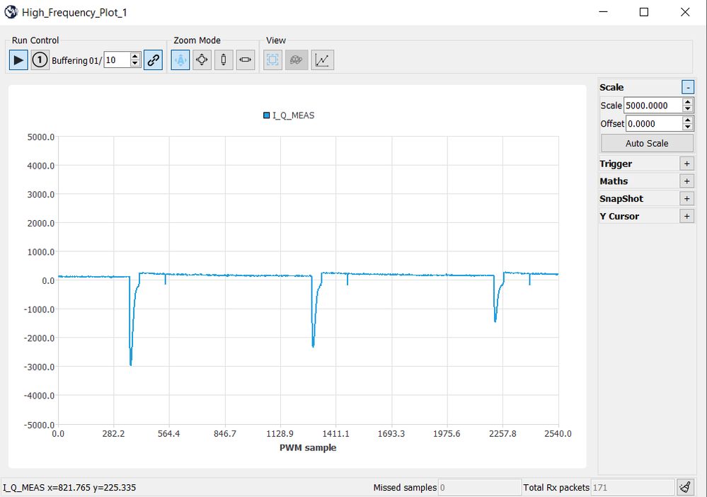

I have the B-G431B-ESC1 development board connected to a BLDC motor.
I generated the code for FOC with the MC-WB 6.1.2 and STCubeMX 6.8.1. Compiled with STM32CubeIDE 1.12.1. Connecting to the board and upload worked well.
I can connect with the Motor Pilot 1.1.12 to the board.
The board generates a repeated beeping noise with 1 Hz frequency. Is that normal?
When I try to accelerate the motor via the GUI, the board initially responds but aborts. It sounds like the "beeping" generator is still active.
To test, I set the duration of the first phase to 10 seconds in the Rev-UP dialog and reduce the torque. This generates the current profile shown below. The current follows the reference value most of the time, but is periodically disturbed. This disturbance follows the rythm of the beeping. If I set the reference current higher (to generate enough torque to turn the motor), the controller trips for overcurrent.
Do I miss somthing?
How can I disable the beeping noise?

I solved the problem in the end by creating a new project in MC Workbench. I previouslly selected the Example project from the first page for the board and this initializes the TIM2 for a synchronization.This seems not to work as a stand alone unit.
