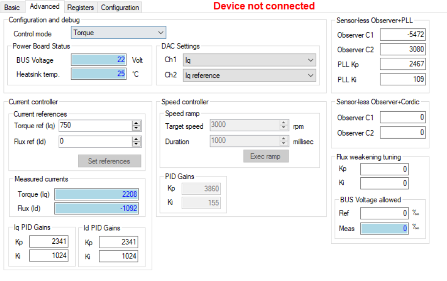

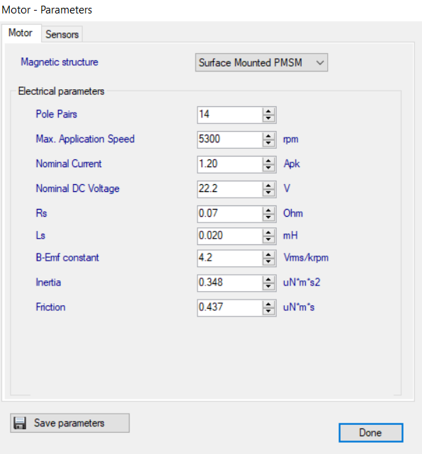

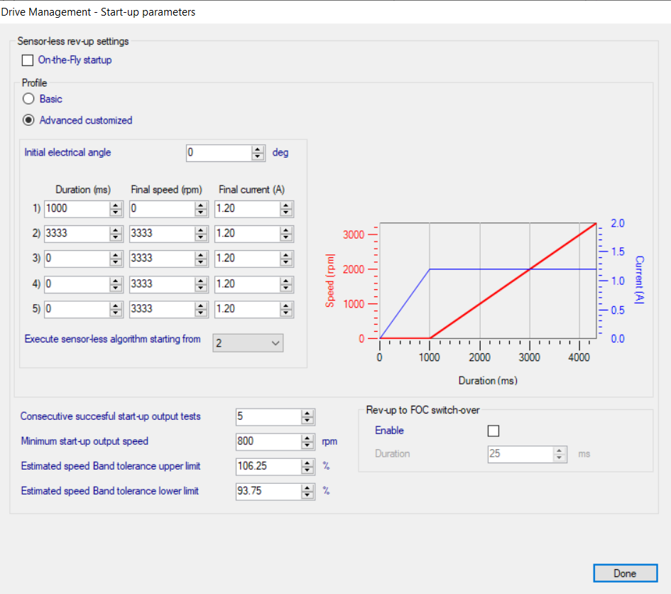

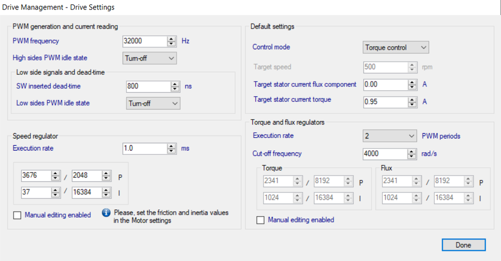

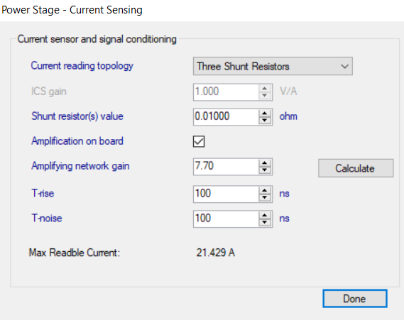

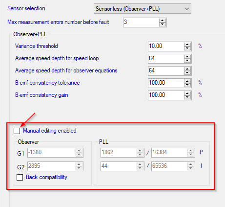

I have sensorless 3-phase bldc motor. I am using MC Workbench for Sensorless FOC algorithm with STEVAL-SPIN3201 board. I've run my motor at torque mode and it seems okay. But, when I loaded motor does not produce any torque and immediately stops. What can be the problem? I've attached screenshots of GUI settings file.

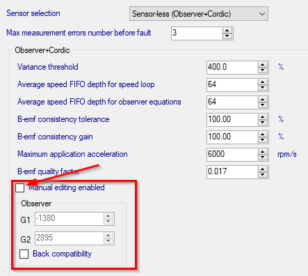

You are probably right. If you get a speed feedback error, then the system went past the startup phase and the motor is spinning. Do you get this error quickly (right after the transition from the startup, open loop phase to the closed loop, sensorless operation, about 4 or 5 seconds in your case)? If yes, tuning the current controller PID regulators will certainly help. Tuning the observer parameters may also help. I am not an expert in these tuning sa I cannot help you much here.
For the parameters, of the observer:
then
in case of State Observer+PLL or
in case of State Observer+Cordic.

No, I don't get this error quickly. When i run the motor to its maximum speed, I do not get any error. After motor reached its maximum speed, i loaded motor and did not produce any torque. Because of this, my motor has stopped and MC workbench gave speed feedback fault.
I will tune current control pid and Observer G2 parameters and test the motor again.
