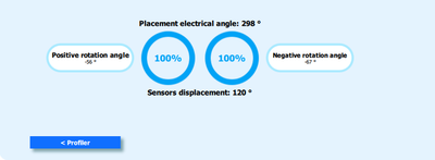

2025-06-29 11:40 PM
I have gone through the documentation i am trying to setup the motor profiler for my custom board but it may take some time for me to understand and setup. But when i see the documentation
it mentions that the motor will run in both directions and i can see positive rotation angle and negative rotation angle and then the placement electrical angle which is different
Positive rotation angle -56Degrees
Negative rotation angle -67Degrees
Placement electrical angle 298Degrees
But when i do the manual method mentioned in the document it is not that detailed
I have tried different hall placement angles within the range of +- of actual value but the performance is always better in only one direction. It has something to do with hardware or software?
2025-06-30 5:03 AM
It has something to do with the quality of your motor.
If you need to spin your motor in both directions you can take the 298 Degrees value which is the average of the Positive rotation and negative rotation.
If the control is not accurate enough with this average value, you can always change dynamically the placement depending on the motor direction.
Regards
Cedric
