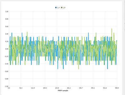

2025-06-27 11:32 AM
Thanks for the reply
This is the capture in Open loop voltage

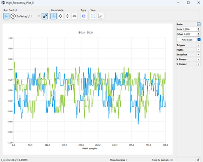

and this in open loop current
