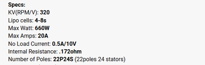

The motor I am using has this specs
So I tried changing the current from 5120 rpm (320*16v) and max current of 20A, successively reducing the speed while keeping the maximum current, down to about 1000 rpm. Then I kept the speed to 5120 rpm and reduced the current from the max of 20 to down about 4 amp. Lastly, I reduced the current and speed gradually from the maximum settings. It was either stuck at 7%/ 28% and at one point got past 71% , but then the Speed Feedback fault came up. I think i exhausted most possibilities and still could not get it to work.

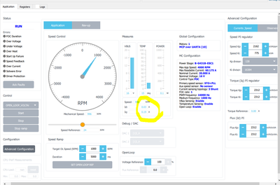

I switched to Open loop procedure. Still I could not get the motor to spin. The speed indicator moves but the currents are very small.
I know that my motor is working because I have another setup (using a different ESC and radio control) and it worked there, I double checked that the wiring from the motor pads in the ESC to the motors are good. I also tried increasing the duration to even reduce the acceleration further but that did not make any difference. What else can I do to make this work?
I know my motor parameters , R L and flux. Is there a way to just enter them in the code and maybe that would work?
