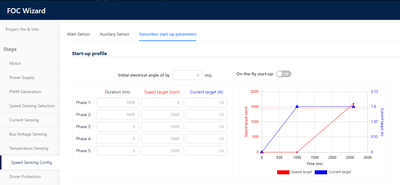

You are able to handle such behavior with the Rev-Up feature on Torque mode:

I recently used rev-up to perform motor load startup tuning. At the time, I didn't realize that it would be the exact feature I needed.
During the tuning process, I noticed that it transitions from an open-loop to a closed-loop startup procedure. Now, with your explanation, I have confirmed that my understanding is correct.
